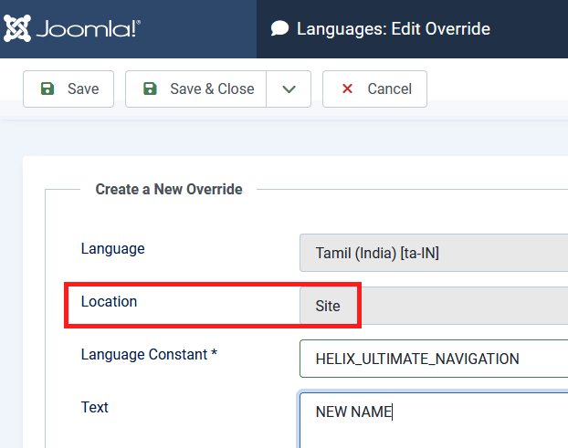

Hello, i am using Helix 3 frame work, joomla 4.4 when mouse is over the icon of menu_of_canvas (three horizontal small lines ) , it displays "Helix 3 Megamenu Options" I would like it displays some thing else. I though css stuff could solve this, but i don't find the class. So, please, how can i change that title for a custom one? Regards jluc

Senior Staff 2 years ago #164355
Hi Jean
As I remember you have to override language phrase - that's all.
HELIX_MENU="Helix3 Megamenu Options"
HELIX_SUB_MENU="Helix3 Menu Options"
One of them should be that you're looking for. Use Joomla Admin: Languages Override feature to translate or customize them.
Using CSS you cannot hide "TITLE" nor "ALT" text.

Senior Staff 2 years ago #164356
Basic Example How it works in Joomla 4.x & 5.x

2 years ago #164372
Hello Paul That's OK. I mean using language override, i can change the chain HELIX_MENU from default value "Helix 3 Megamenu Options" to a new value. The difficulty is to know about the different chains. I mean, if you did not tell me about the chain HELIX_MENU, how would i have found it. Is there a place where to find them? Regarding the solution, Once again, exactly what i was looking for. best regards jluc

2 years ago #164373
Hello, Yep, i found! I did not understood firstly how it worked. Firts get the language, then search the value you want to change, it will give you the chain. Then from the the chain, you can change the value for whatever you want, then save and close. Regards Paul jluc.
Senior Staff 2 years ago #164378
If you know the phrase (As you did), you don't have to search , just put and translate.
