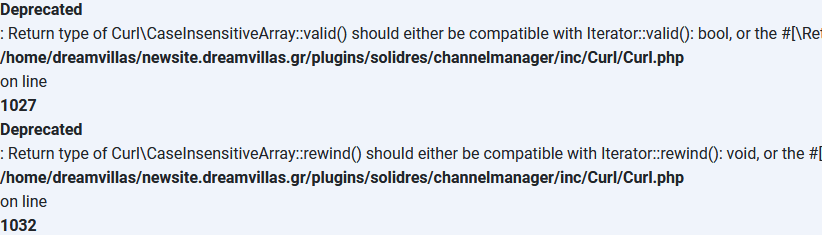

Hello. After updating joomla 5, this problem occurs in the accommodations. Failed opening required '/home/dreamvillas/newsite.dreamvillas.gr/components/com_users/helpers/route.php' (include_path='.:/opt/cpanel/ea-php83/root/usr/share/pear')
Can you help me?

Thank you for reaching out, and I apologize for any inconvenience caused by this oversight. Disable this plugin and check again. Besides, You need to contact with the Solidres Extension Provider.
Solidres - Channel Manager plugin
I can confirm.
Plugin "Solidres - Channel Manager" is not fully compatible with PHP 8.3 - that's why you have Deprecated error messages (!)

Chris, how you can have the same error not having that plugin from Solidres, hmm?
First user here, had a problem with Accommodations from Solidres, not SPPB itself.
