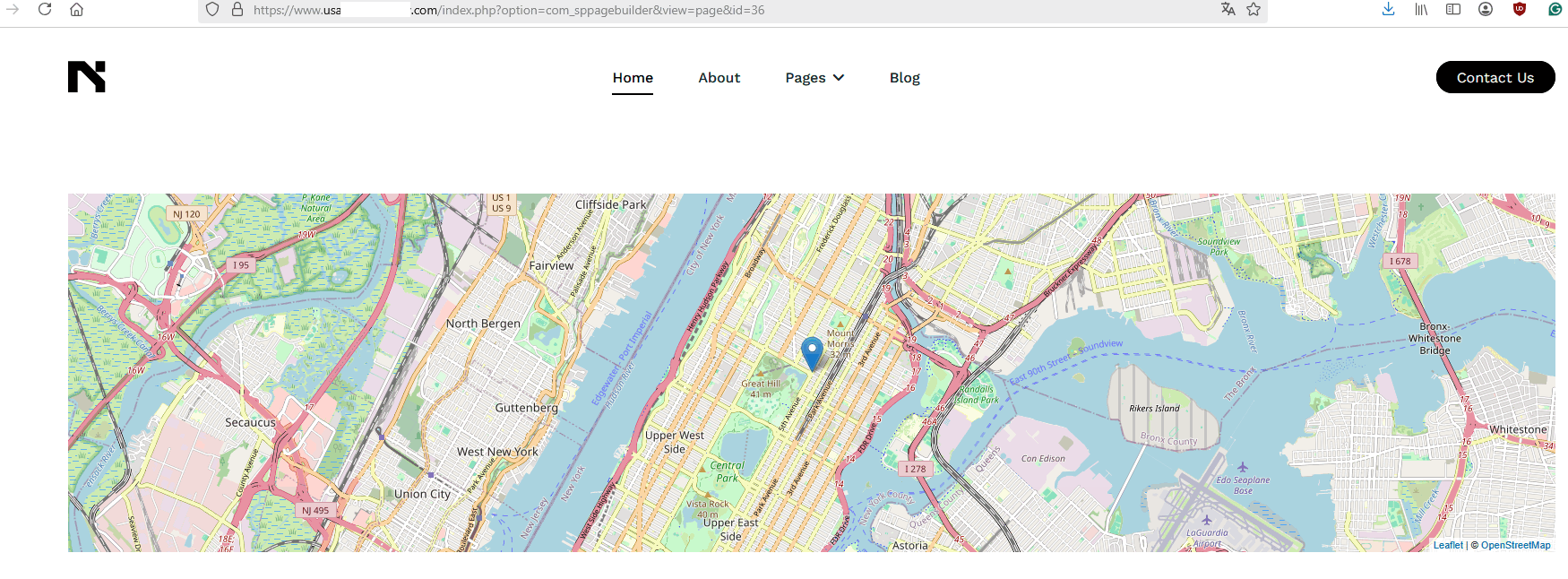

One of sites.

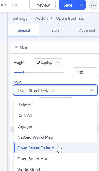

If we talk about SP Page Builder Pro 5.x - edit Open Street Maps addon , change style, Save changes and check again. Then repeat with different Style. Remember to clear Joomla cache.

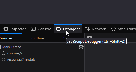

Check also what Inspector > Debugger will tell you (Firefox and Chrome has it)
Firefox screenshot
