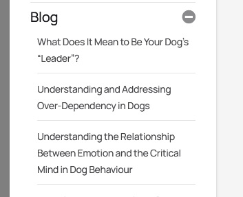

Use also that
.offcanvas-menu .offcanvas-inner .sp-module ul > li a,
.offcanvas-menu .offcanvas-inner .sp-module ul > li span { line-height: 22px;}
Then blog menu items (Mobile Menu) will be like that
