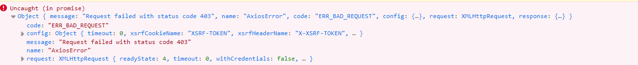

unable to save SP page, getting this error "Request failed with status code 403"
please provide solution

Since when you have that issue. Becuase I saw that your site is using SPPB already. Maybe that problem is caused by Security extension that you have there. This is popular reason of 403. If you have any, disable and recheck, and if that helps, contact with extension support how to solve it / correct settings.
See updated Admin URL and notes in hidden content
I think it's caused by Akeeba Tools Pro settings. Quite popular.
Yes, it was caused by ATP security level. I used WAF Exceptions to fix it - but please ask Akeeba Support - how it can be done better, and share answer here, so I will be able to update documenation.

In general, it's not SPPB issue, something else is blocking process of saving. Otherwise you would have the same 403 everywhere.
I was able 8h ago create "ABC JoomShaper Test" but now "SAVE" don't work again ??!!!
The error Request failed with status code 403 in Joomla (with a message from Axios, so it's probably JS/AJAX in the background) means that the browser received a Forbidden response from the server when it tried to save the page via an HTTP request.
Some extensions (e.g., Admin Tools Pro, Akeeba Web Application Firewall) or modules ModSecurity on the server block POST requests if they contain “suspicious” data.
Browser Error Console on Page view tells that
So yes, I would disable ModSecurity for 15min and recheck. The same with CloudFlare.
If will help, you have to make SPPB trusted in that software. Hosting Support should help more. My options are limited.
