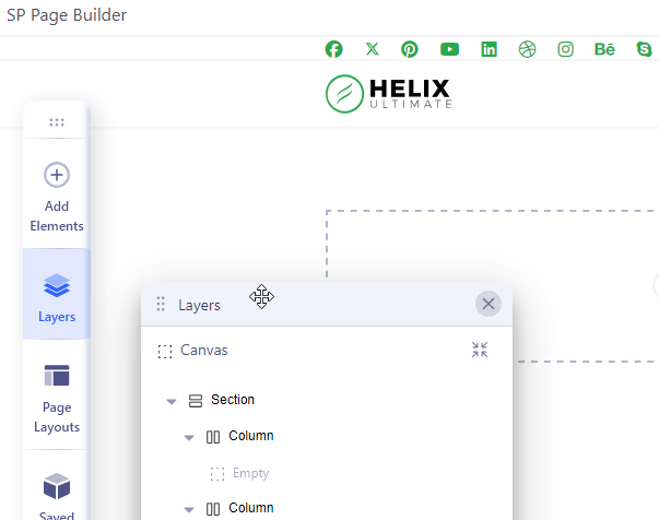

Hoi,
You can access layers from the front-end sidebar editor of SP Page Builder only.
It means that you have to be logged on front-end, and then you should be able to see it. It doesn't work in back-end editor.
Step 1

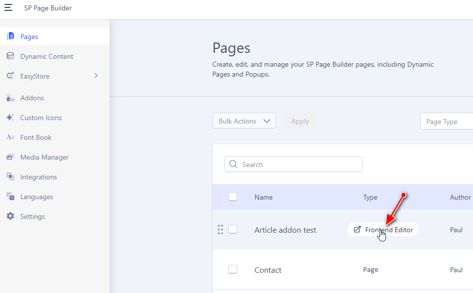

Step 2 (after being logged)
