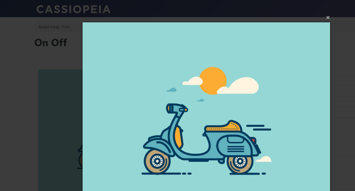

Please make a simple test - switch to Cassiopea template (make it default for that subpage - menu item) and recheck. To be sure, I made the same test with Image addon
