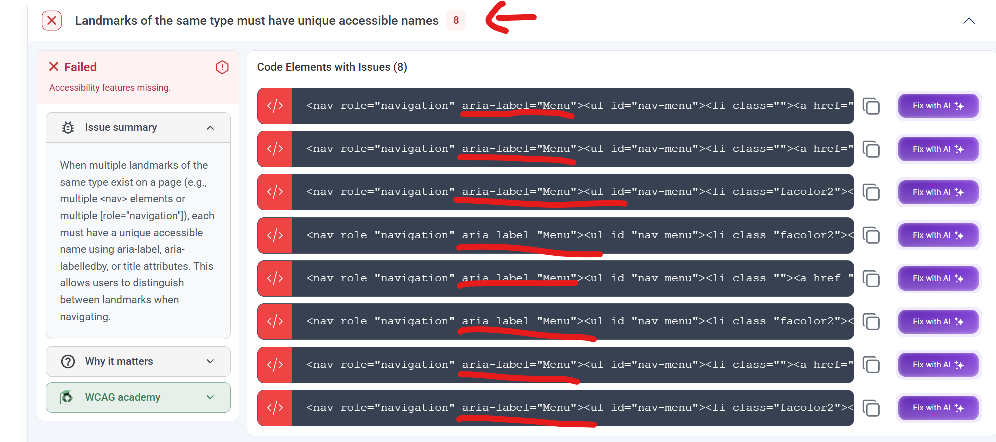

  1. I'm really glad you care about accessibility. I would like to ask a few important things for this. I use the navigation part of the SP. It looks like this:
    <nav role="navigation" aria-label="Menu">
    But it's all on the page and that's a problem. Each such element should have a unique aria-label.

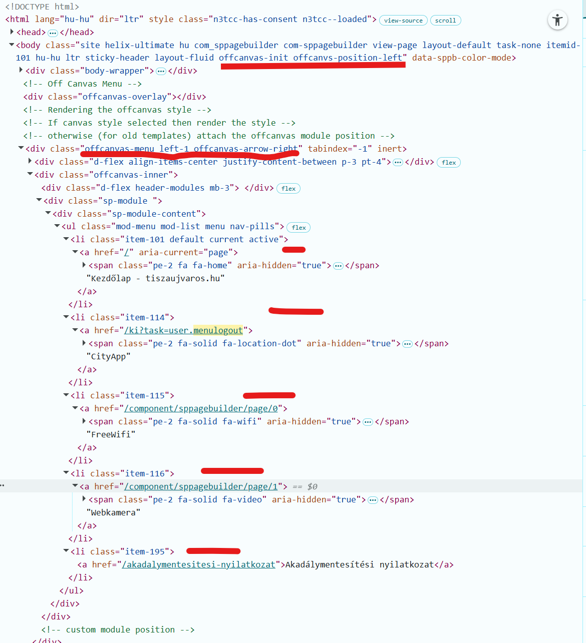

  2. I found an interesting bug in the HELIX framework. I don't use the framework's menu system. However, it does incorporate the off-canvas menu type into the page. The layout does not contain a module position pointing to a menu. There is no menu type module on the Joomla page. What I'm using is an SP module that has a button group. This is interesting because since off canvas is a hidden element, the menu links must contain aria-hidden="true" (ARIA). I noticed this when I checked the accessibility.

Hi! It would be possible that in the next version the following correction could be added to my comment in point 1 above:
components\com_sppagebuilder\addons\navigation\site.php line 64
$output .= '<nav role="navigation" aria-label="Menu"><ul id="nav-menu">';
instead of:
$output .= '<nav role="navigation" aria-label="' . $responsive_bar_aria_label . '"><ul id="nav-menu">';
This would solve the unique aria-label.
