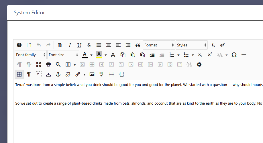

JCE 2.9.99.10 + SPPB 6.7.1 + Joomla 6.1 [screenshot from today]
and as you can see JCE works inside Text addon in full width view, as before. If somehow doesn't work on yours - share access
