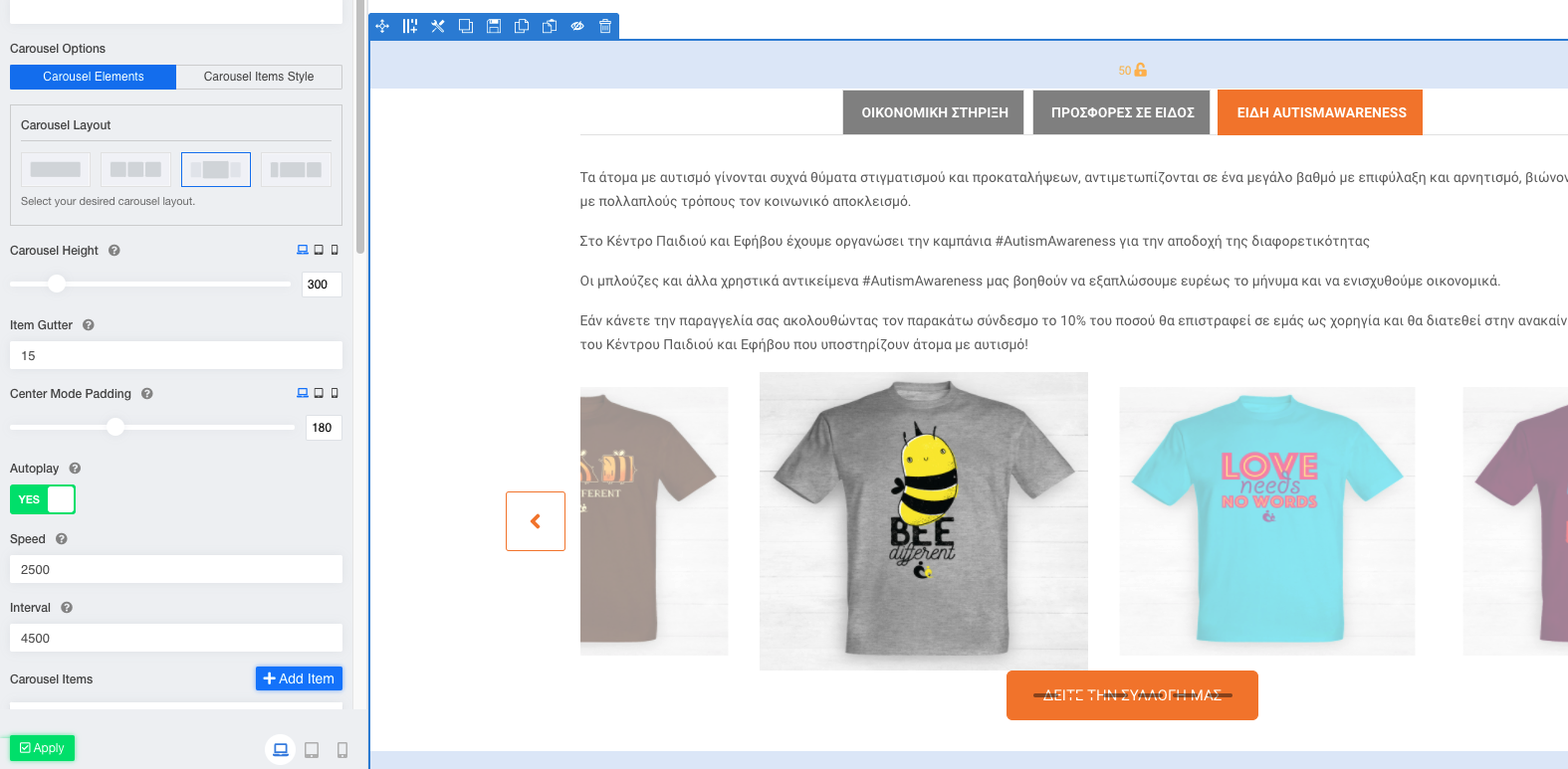

I am trying to create tabs and I want to have inside tabs a module and an image carousel, when i create it I get no images (screen shot https://prnt.sc/15e942t)
Any idea why this is happening? Also i tried to create the image carousel into a module and used this module into the tab but still the same result, no images at all.

Marked as the solutionHello Pantelis,
Please, check your page. It seems like a bug in the second layout of image carousel inside the tab. I have enabled the third layout of the image carousel. And it's working fine. We have already informed the developer team about the bug. They will fix it soon.
-Regards

It is a bug and they are going to solve it, until then you have to use the third layout at the image carousel
