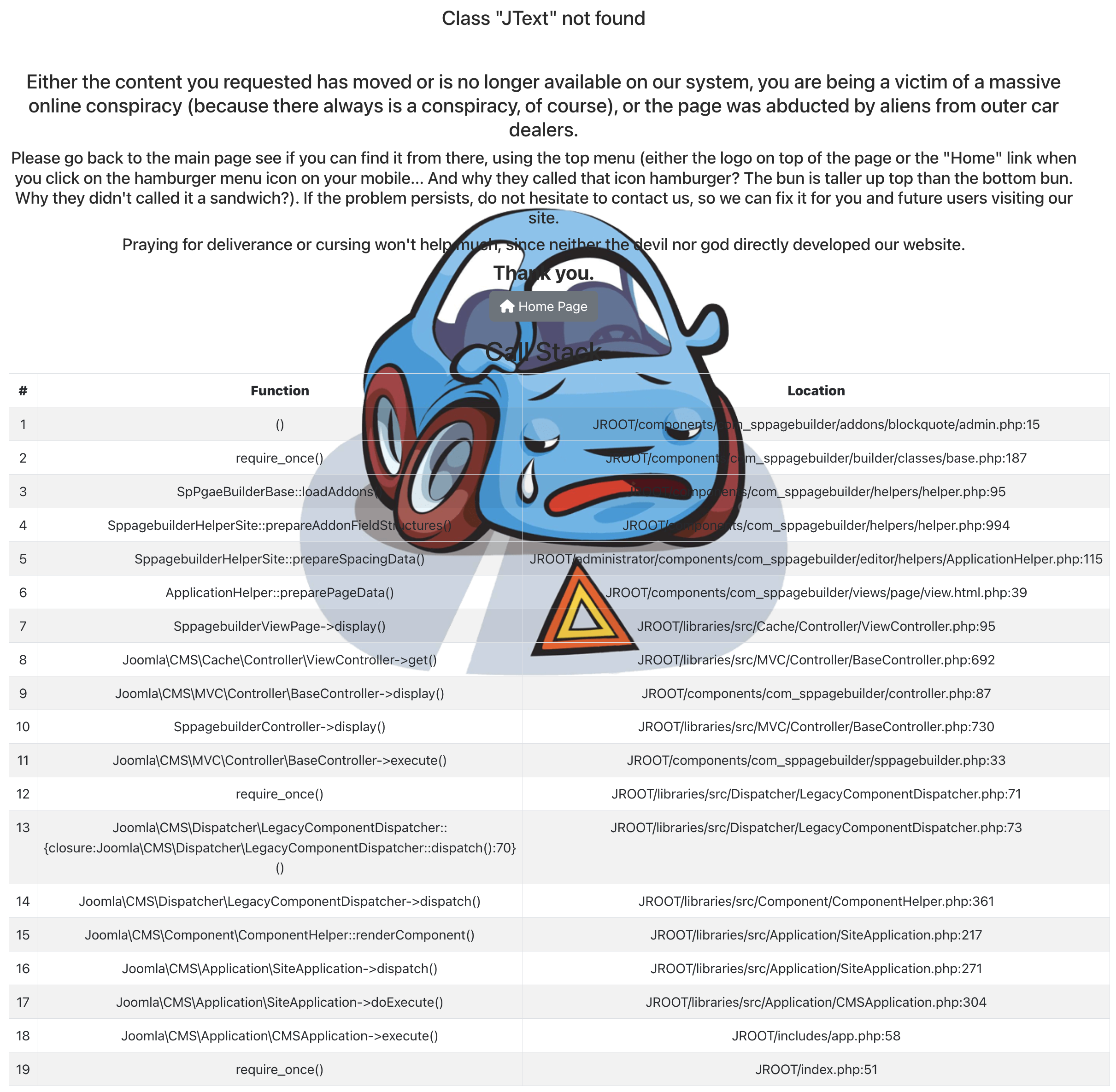

I included screenshot of the site screen msg after disabling.
Error screenshot

Delete that addon (blockquote) folder; it's not supported anymore. That's why it cause problems.
Path you have in your screenshot.
GarageCentraal Asked this

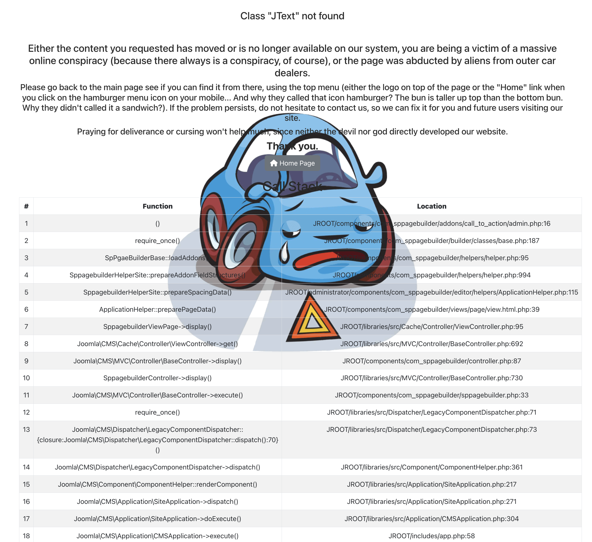

The folder has been deleted, yet the error screen shows up the moment I disable the backwards compatibility plugin

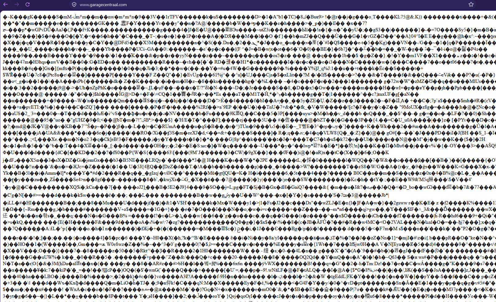

new error
Provide me FTP access. One of your regularlabs extension occurred the problem.
