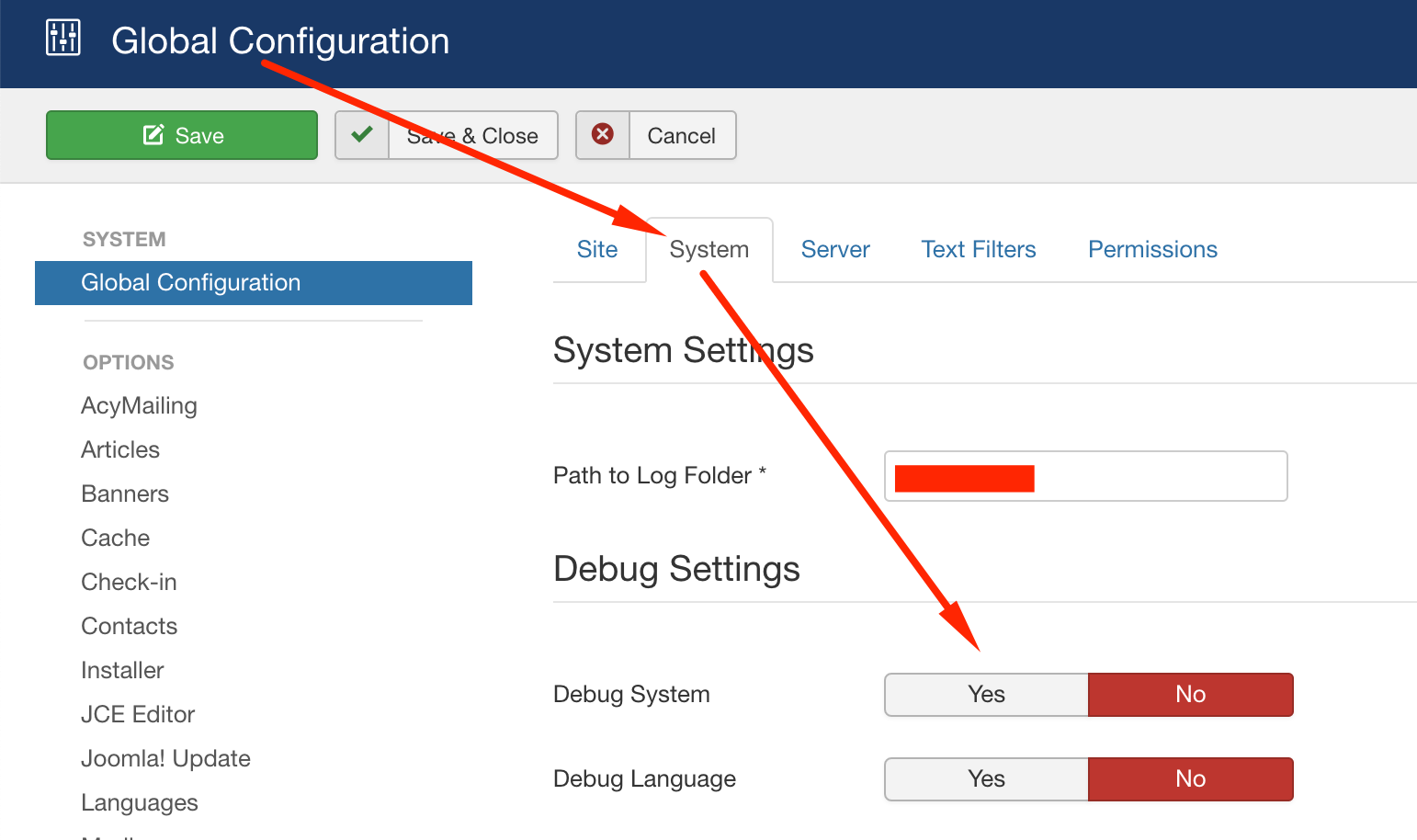

In this location: /sppagebuilder/addons/slideshow_full/site.php I have changed line 58 from this $subtitle_data_attr .= ' data-sppb-wow-duration=“' . $subtitle_animationduration . ‘ms”‘;
to this $subtitle_data_attr .= ' data-sppb-wow-duration=“' . $slide_item->subtitle_animationduration . ‘ms”‘;
In the Global Configuration -> System, keep Debug System off, then you will not see the debug console.

I could not see the error now. I have turned on Debug mode on Global Configuration -> System and Error Reporting to Development on Global Configuration -> Server. Please guide me which page has the error.
