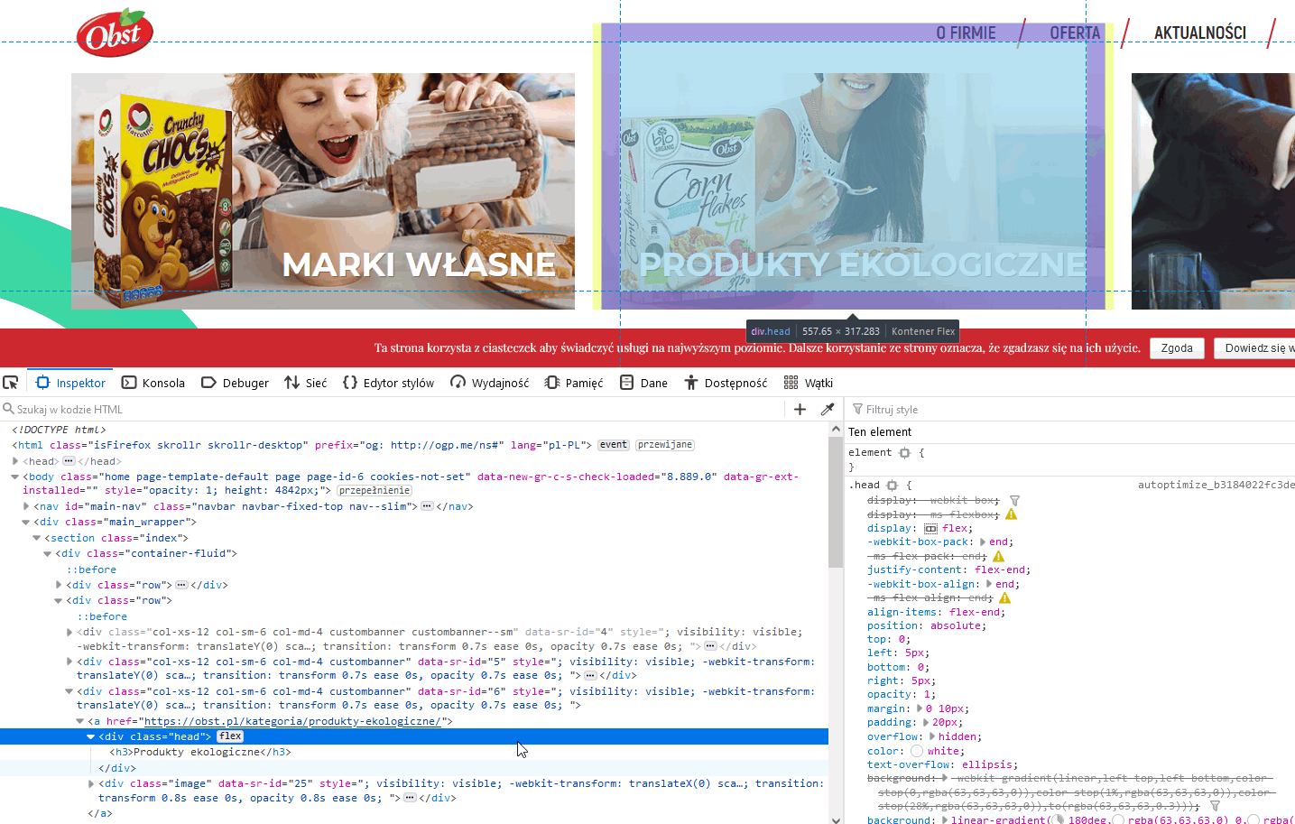

But how and where, appropriate modifications should be made? I am committed to achieving such an effect: https://obst.pl/

Have you seen CSS code that they used, it was quite simple, you can use similar as webmaster. I mean text with link inside should fill whole box. You can try with Raw HTML addon.

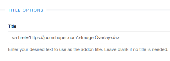

In Image Overlay addon you can use link for title
but I think the simplest option will be just a simple customizaton of tht addon code (site.php) to add link < a href="/... taken from Button before class sppb-addon-overlay-image-content.
