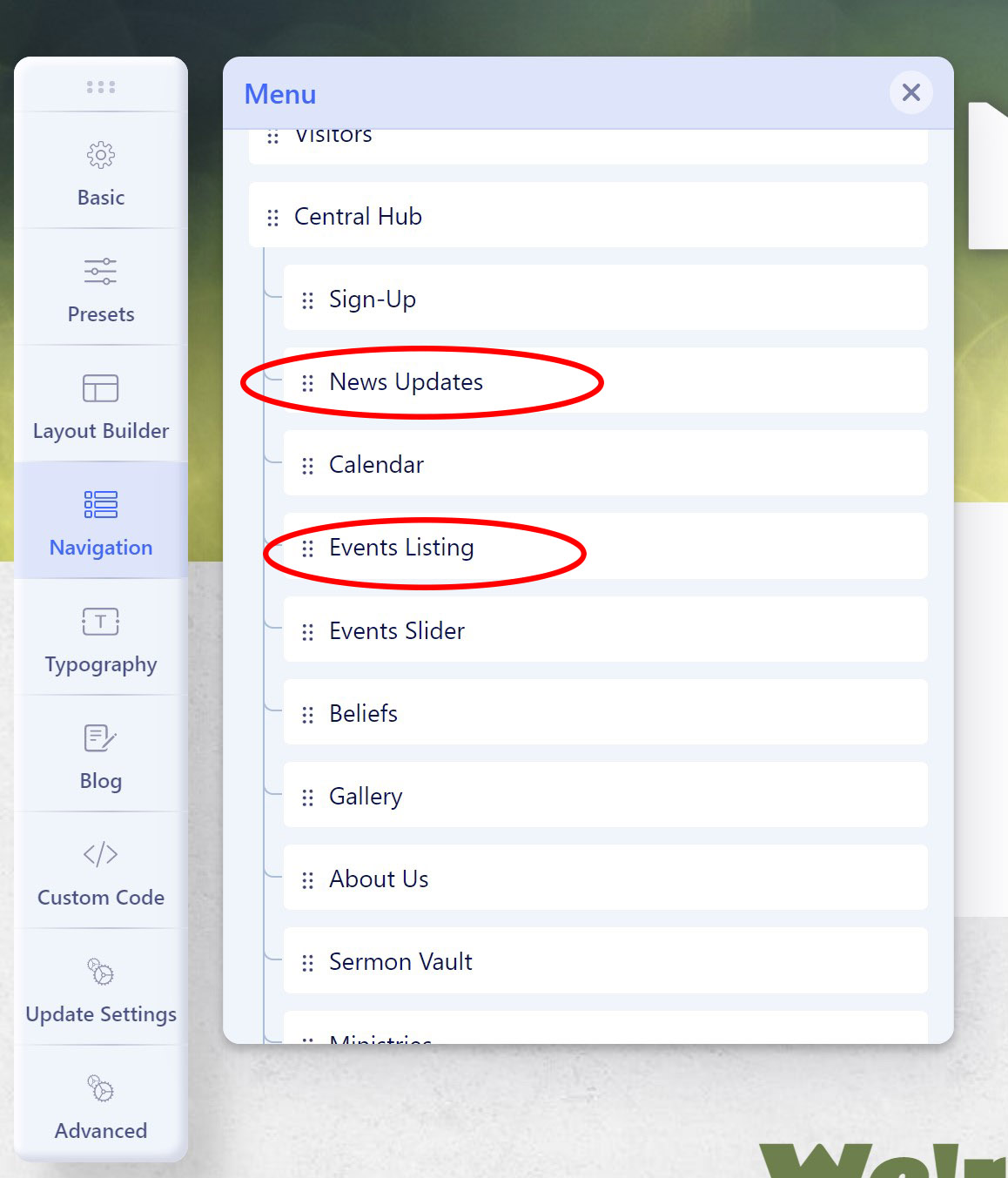

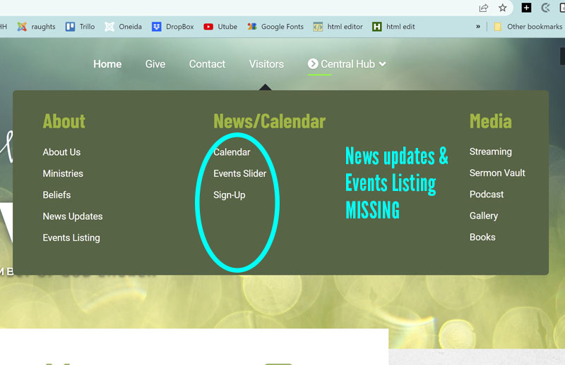

In my main menu, I created a mega menu with links. Later I added more links to the mega menu. In the backend, they are inside the megamenu, but in the front end, the links don't show up.
I've added screen shots to help explain. You can check the website at: www.holyhoster.com/nl and hover over the CentralHub link in the main menu.
Any help would be appreciated!

I can see the items you have indicated on the backend screenshot.
Here is a screenshot of what I can see: https://prnt.sc/26t8m2d
Would you please clear your Browser cache and check again?

I played around with several mega menus trying different things to get it to work. Then I realized that by some coincidence, I was able to add two links but could not remember what I did to make it work. This happened a few times and could not figure out what the order steps were. Joomshaper's documentation is not good or up to date...as far as I could tell.
These steps helped me to get it to work.
  1. Create mega menu
  2. Add links to mega menu in the regular menu page
  3. Go to manage menus > select menu that holds the mega menu> select "BUILD"
  4. Go to Template>Navigation>Mega Menu and create layout.
I don't know if there is a better way to do this, but it took me hours to get it to work. I asked for help because I thought it was hopeless so I accepted your answer because you would have shown me. If there is a better way, let me know.
