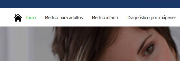

I would like you to help me with the configuration of the HELIX ULTIMATE template.
I need to reduce the height of the menu since the distance between the header and the body is very large.
How can it be done?

Hola,
to reduce space between header and component area read tip 2 from >> https://www.joomshaper.com/documentation/helix-framework/helix-ultimate-2/customization-tips
Header height you can control in Helix Ultimate options : Basic -> Header | info: https://www.joomshaper.com/documentation/helix-framework/helix-ultimate-2/basic
And to reduce Menu height please correct line-height value using CSS (now you have 110px), I suggest using 60px
.sp-megamenu-parent > li > a,
.sp-megamenu-parent > li > span {
  line-height: 60px;}

Thanks for answering.
I have reviewed the suggested content and added the custom CSS code.
Unfortunately, I did not manage to reduce the space of the menu area.
Does anyone know how to fix this issue?
 #offcanvas-toggler {height: 60px;}
 #offcanvas-toggler,
 .sp-megamenu-parent > li > span {line-height: 60px; }
Use it inside Template Options - Custom Code - Custom CSS
After using it
Remember to clean Joomla cache.

You forgot that you have JCH_Optimze installed and enabled. And it cache views, also from template.
I don't know why you forgot to update Joomla for last few months, I did it, but it was your task! Oh.
I put my CSS code (from above) inside custom.css file - becuase probably you want to use it in all styles.
