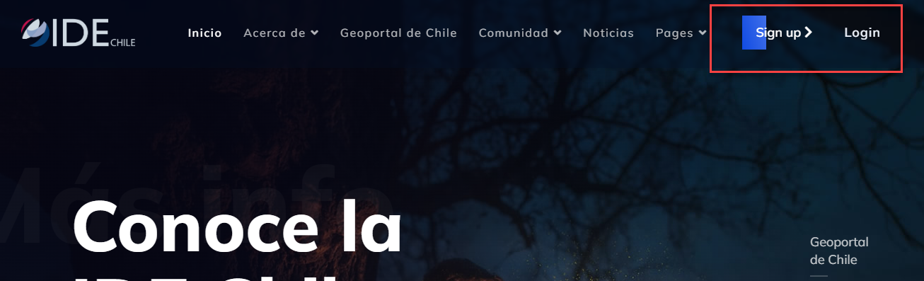

I am using the Pitech template and I need to disable or hide the Sign up and Login buttons that are present in the menu bar.
Please indicate where to do this configuration.

Thanks for contacting us. Could you please give me your site URL and also screenshot of your issue? I need to check.
The site is currently in a development environment, so you will not be able to see it.
https://i.ibb.co/SVb5SPv/26-09-2022-12-31-35.png

I think that a module in the menu position
Please go to your Home Dashboard --> System ---> Site Module
Then find module SP PageBuilder in the "menu" position then unpulish it

I disabled the module named "Menu Buttons".
