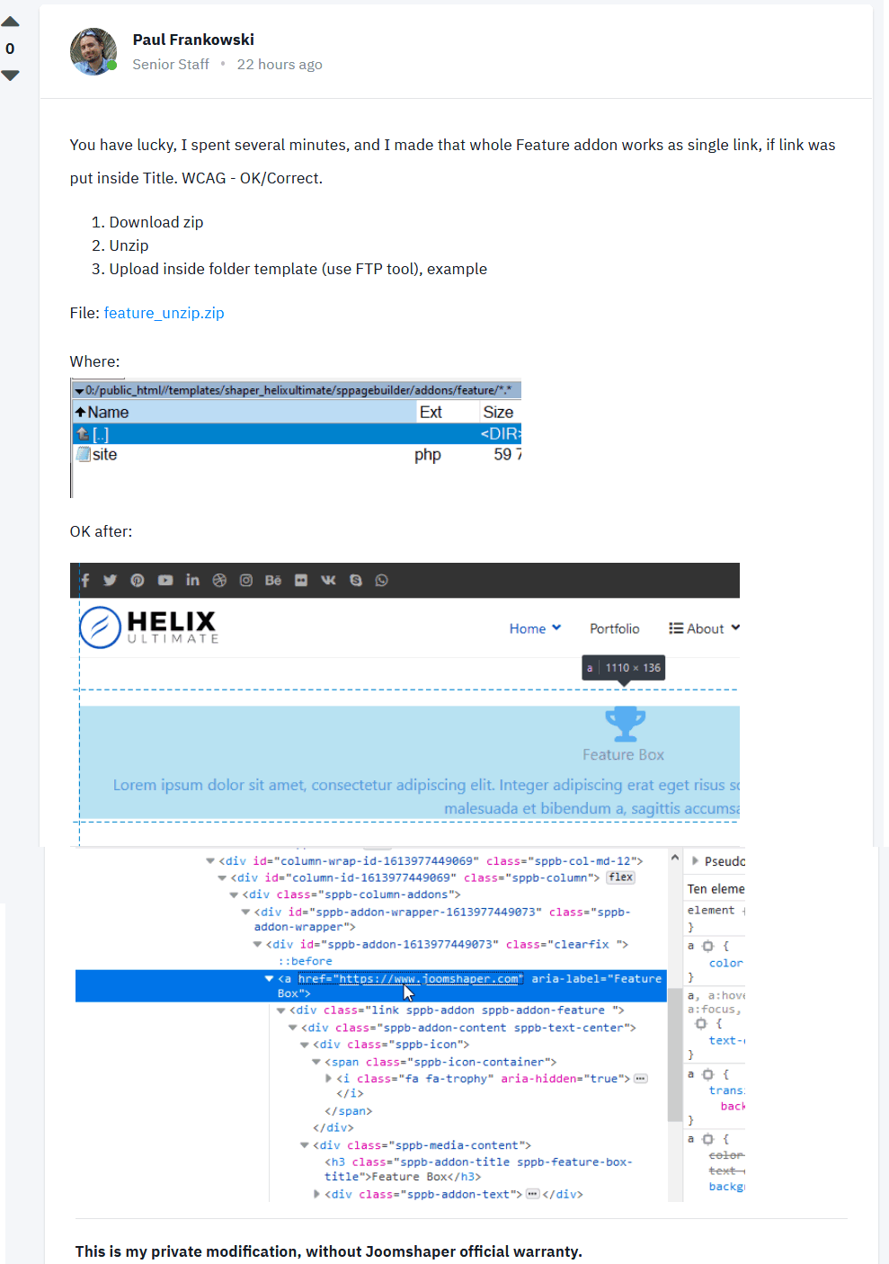

yes, as Toufiq said, in general you have 3 options by now:
  1. Join forces with user: https://www.joomshaper.com/forum/question/1858 - where we discussed the changes that need to be made.
  2. OR, use RAW HTML addon where you would add icon and text and link around. This is not a article so made ones won't be updated for a long time. So you don't have to be worry.
  3. Use link only for title inside Feature box.

Oh, sorry, I forgot.
Screenshot and file under
