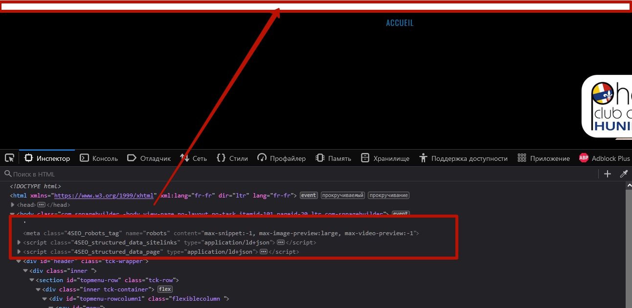

I need you to fix that today ( i have the meeting in 8 hours) :
Menu doesnt appear anymore AND i have a symbol ' apperaring on top white line !! i dont know why....

Hi. The template is to blame. SPPB works inside the component area and cannot affect the entire site.
Here is the code for quick correction
#menu ul.menu > li > a, #menu ul.menu > li > span.separator, #menu ul.nav > li > a, #menu ul.nav > li > span.separator, #menu ul.maximenuck > li > a, #menu ul.maximenuck > li > span.separator {
    color: #fff;
And more, you have a mistake in 4SEO scripts.
This should not be there and it is causes problems.
i'm making some tests, with external templates to find where the problem could come from.
My code above for the template that I saw. If you want to use Helix switch to it
