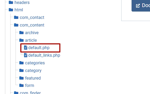

For example, if you want to override article > default.php (which already exists in Helix from the box)...
...use own Helix override system.

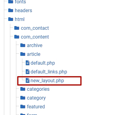

If you want to create a new override with own new file name, like article > new_layout.php...
...use standard Joomla means.

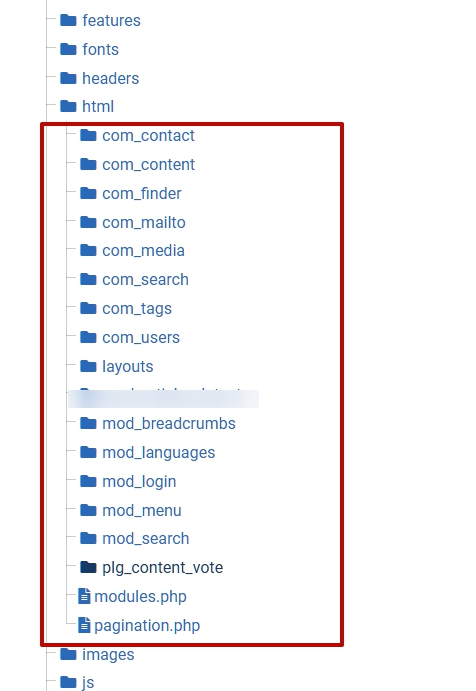

Hi Peter. Helix is supplied with overrides already available on board. To override these overrides, use own Helix override system.
For any other overrides that are not in the list below, use standard Joomla means.
Overrides that are in Helix from the box:
