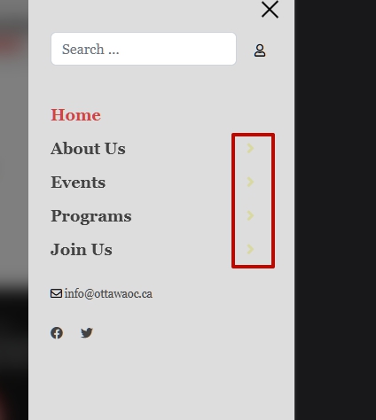

1..Off-canvas menu -I have set - in menu-> off-canvas maximum level All - however the submenus do not show. How do I get the full main menu to display in off-canvas?

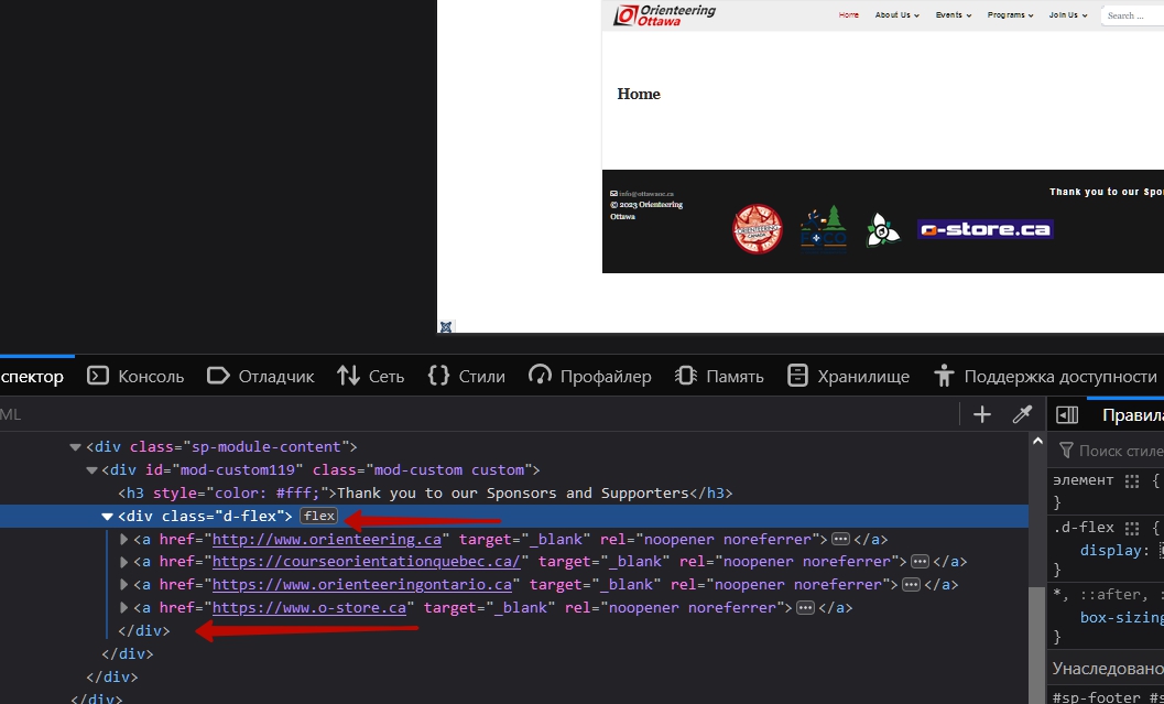

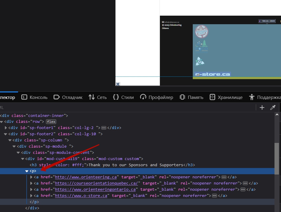

  1. in the footer I have a module "thank you" that shows 4 images for the logos of supporters with links to their sites. In the code it is a horizontal list and that is what it shows for the same code on ottawaoc.ca. However, on ottawaotest.ca/oocj4 it continually displays stacked vertically although it has 3/4 of the screen width to display. How can I get these to display horizontally? The code is shown in hidden.

Hi.
  1. They are there (by clicking on the arrows)
  2. Change from p to div with d-flex class...
    ...something like that...

Pavel, thank you for the solution to the problem with the footer. That looks good now.
Also the offcanvas menu - I see them now and am working on changing the color coding.
