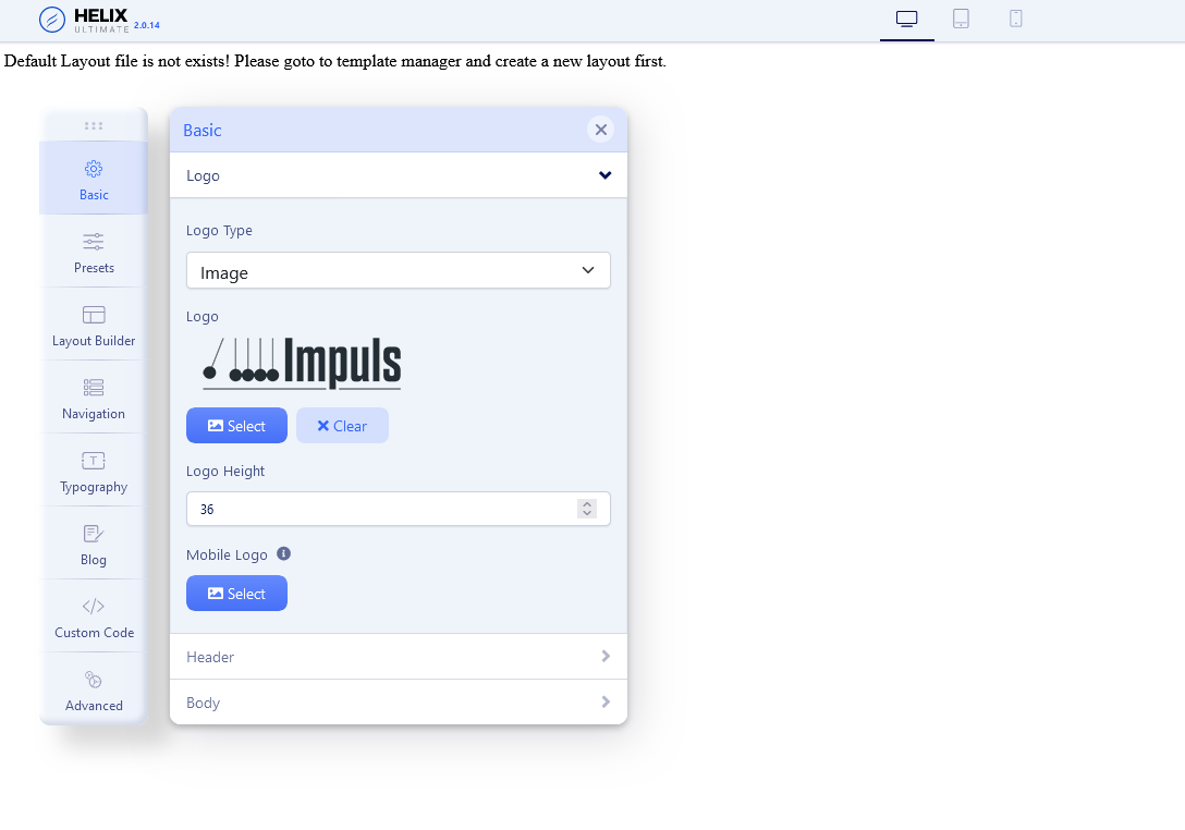

Hm,
after that I upload logo on Template options and I got error: Default Layout File is Not Exists!
Now I lost top bar, logo and menu...
I try to create more layouts and test and this is same.
What is problem with this template?
I have checked the logo option. I have not faced the issue. Please check again.
