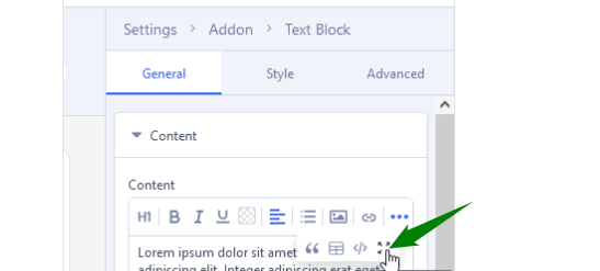

My Joomla global configuration has JCE as the default editor but SPPB 5.1.8 is using TinyMCE.
How can I change SPPB to use JCE editor?
8 replies
Hi Oscar,
click here:
then you should see jce editor
Allen

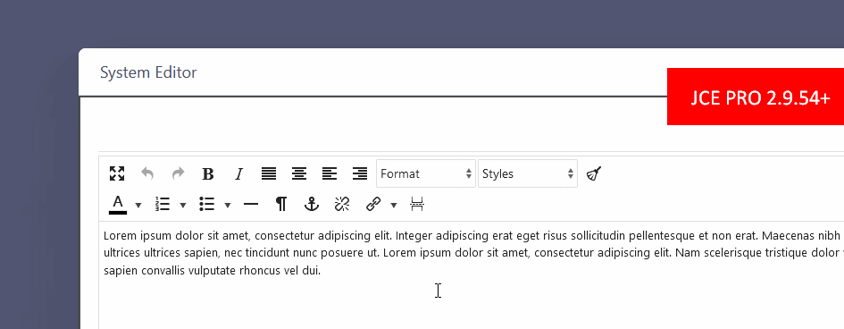

I'm running SPPB Pro 5.1.9 and JCE 2.9.54 as my system editor on J3.10.12.
When I follow your guidance, I get an error page:
Please advise.
  • Allen
