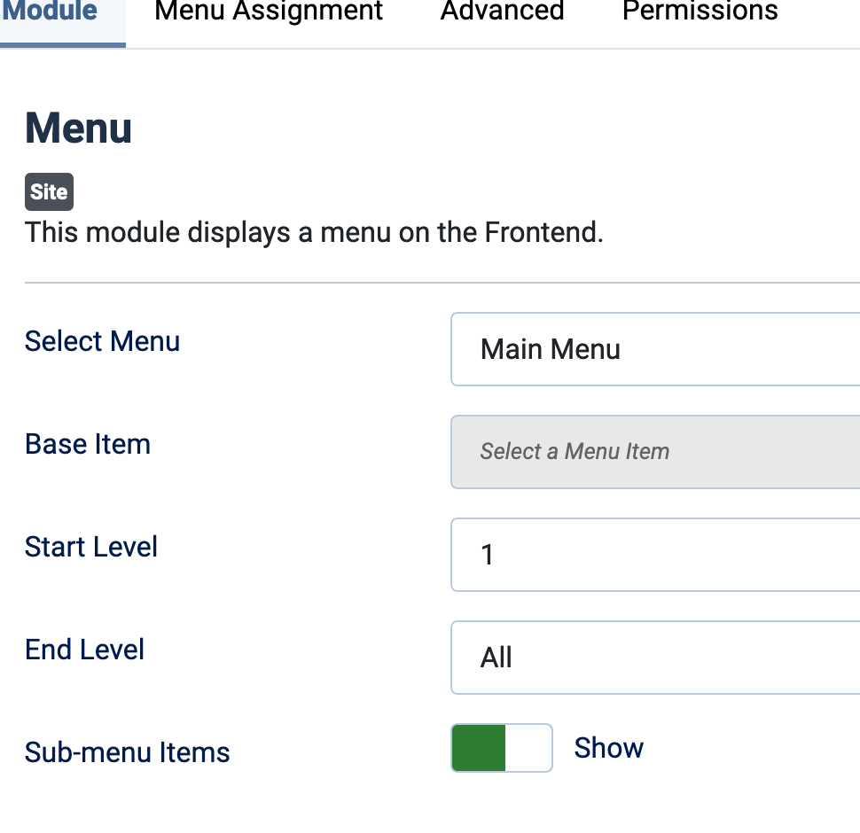

Check both 1 and 2:
  1. Module Manager (list of modules) > Find "Menu" module published in "offcanvas". Compare those my suggested settings with yours (End Level: All, Sub-menu Items: Show) > Save
Screenshot 2024-05-03 at 19-41-54 Modules Menu - joomla 5.1 - Administration.png
  1. Template Options > Menu > Offcanvas > Maximum Level: All > Save

Thank you so much. It worked perfectly!
