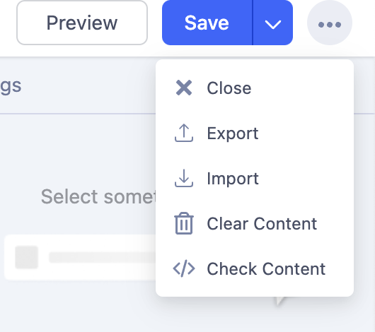

I've created two seperate galleries with the sp pagebuilder module.
The images per gallery are from a different folder
I load them with an ID : {loadmoduleid 129}  and {loadmoduleid 130}
I've already given the sections for the pagebuilder module different id's.
I load both galleries on the same contentpage.
No matter what I try, the thumbnails for the galleries are perfect but when
I click to view the gallery as a popup both galleries show all the images.
So if number 129 has 6 images and 130 has 4 images both popups show
all 10 images.
Is there a way to fix this? I've already tried if adding image by image or bulk select
items makes any difference but no.
best regards Marie-Anne
Apology for the delay. The issue was in the modules. I have used Check Content option on the modules. It is working fine now.
