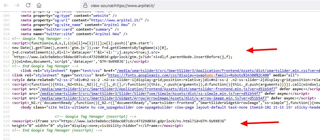

I tried to install GTM on the site www.arpitel.it that uses the Investa template, inserting the GTM code in the "Custom Code" tab of the template https://ibb.co/3YrCzy9 .
I did a test with the GTM preview, but the tag is not found https://ibb.co/2jz0Xdh

Ciao.
Screenshot from your site, as you see code is there, line 611 nad 628.
Yes, anytime you can use PhocaSite (Free) plugin and do the same, as alternative method. For Google it doesn't matter how it was added.
Pio Asked this
The first code should probably be pasted as high as possible in the head https://ibb.co/ZJ73RXP .
Maybe this is the problem?
Pio
Who knows... I don't work in Google office to ask somebody.
In that case you can try to use plugin if that make any difference.
OR
Edit template index.php and put code manually.
