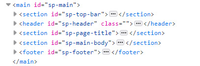

Hi! I am glad Helix got full Joomla 6/php 8.4 compatibility, but the new version messes up the code when it comes to custom layout.
I have this layout: https://prnt.sc/KuZg-wX6afj2
But as you can see, it is generated like this: https://prnt.sc/4eTRS9qMgmWl
The header and the footer are outside of the sp-main, where the other rows are located. Normally the header and the footer should be inside the sp-main.

Please use this fixed version 2.2.1RC, before offcial update >> https://limewire.com/d/S2CjJ#jhpzLAyN1O
and let me know after.
About Layout, after it should look like that (if Custom Header)

This happens on predefined headers as well, not just custom layout. The #sp-header and #sp-footer are pulled outside of the <main> container.

First, today's update v.2.2.1 should fix two problems, PHP 8.1 and Top-bar & Header + Layout structure. Team is working on it. Sorry for the trouble.
Temporray you can reinstall with the older version 2.1.3 >> https://limewire.com/d/bb5t4#s9xiW0ZLqc

Hi Paul I tried it and it works.....
Thanks for that....
