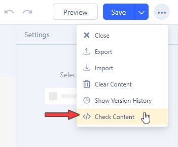

Senior Staff 5 months ago #221041
Tip!.... after you will export and import page, for each page click that (screenshot) in SPPB editor.

I thought there must have been more people with the same thing and that there would be some experience. I am going to test and try it out. Thanks for the answer Ofi and the tip paul. Regards, Grafiek

5 months ago #221103
Hi Paul and Ofi, In my case directly from J3 to J6 works with export/import function with the json file. Not possible is one or more sections from a specific page. So you have to do the whole page in one time. And also specific css is missing (off course). So i have to style things and also make custom css. I use after import the 'Check Content'. But all over it works well! Thanks. Regards
