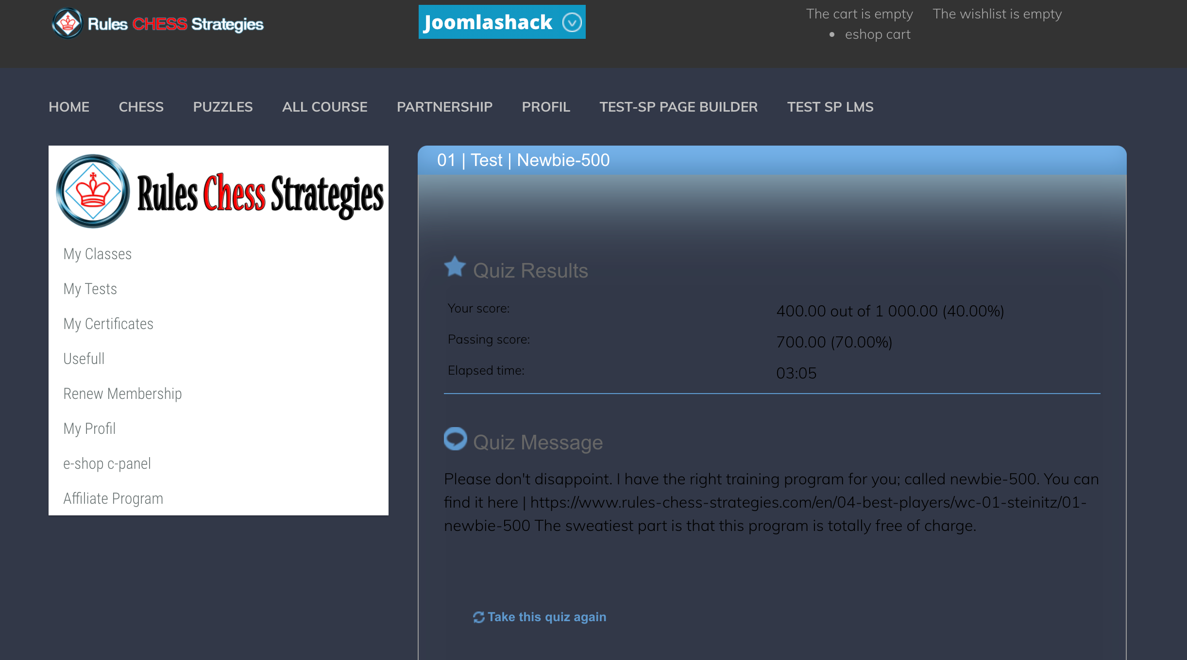

I have a problem with the final backround image as you can see here: https://imgur.com/a/UMGwRa2 I added the following code but it seens that it's not working propertly...
.splms.view-splms-quiz .result { background-color: #20ce31; }
    Please advice

Support Agent 4 years ago #29502
Please use this CSS to Template Options -> Custom Code -> Custom CSS for Joomla Quiz Delux
.jq_results_container tr td, .jq_fmessage_container tr td{
    color: white !important;
and this CSS for SP LMS
.splms.view-splms-quiz .result.active{
    color: black;
    background: yellow;

Unfortunately, none of these features exist. But I will share your feedback with the developers for improvement. Please share the background image issue page link. I will try to provide the CSS for it.

Here is the page, LINK: https://www.rules-chess-strategies.com/en/newbie-500 at the end of it you can see the 2 puzzles. I think that I cannot share the direct link you have to pass the test; it could take to you some seconds by juct pressing always the first answer.
Thanks in advance, Angelo
Support Agent 4 years ago #29491
I am currently in this page now. Is this the place you want more readability?

This quiz created with joomla quiz delux. If you can provide brifly some code there (maybe white color text) you're welcome.
Mainly I was talikg about your extention that is here, LINK: https://www.rules-chess-strategies.com/en/newbie-500?view=quizquestion&id=1:test-newbie-500-intro-to-chess
Thanks for your support!
