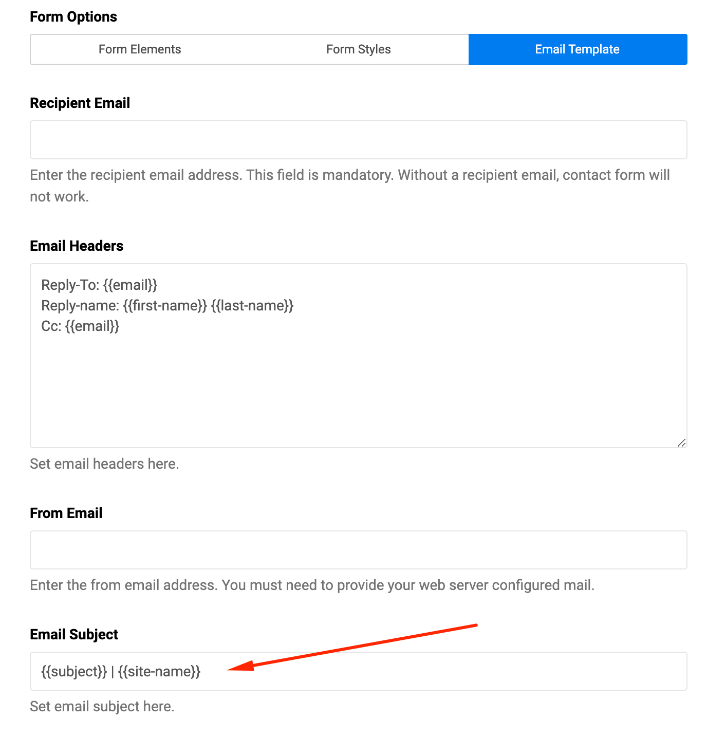

I have created a page Contact Form and tested it. It works for me. Please check again.
Admin - Blooming Wild Asked this
Your page uses contact form and mine uses form builder. Please check my page "test-1" which has contact form at the bottom working but form builder does not.
Please create the page using form builder and your see it wont work.
Your issue is fixed now. Please check your site.
Could you please let me know what you fixed so I can implement on the main page? You fixed the test page.
In the email subject, you had {{subject}} | {{email}} | {{site-name}} which created the issue. Use {{subject}} | {{site-name}} instead.
