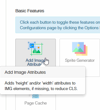

Senior Staff 4 years ago #49881
Ciao,
you can also use JCH Optimzie Pro extension and use this feature.
Marco Lungo
Marco Lungo
4 years ago #49915
Ciao Paul, I have installed JCH Pro but it causes problems on video (in some circumstances it disappear), distrortion of the images and so on. May I am not able to set correctly the component, but this is not the first time that I have renounced to use it. Thank You!
