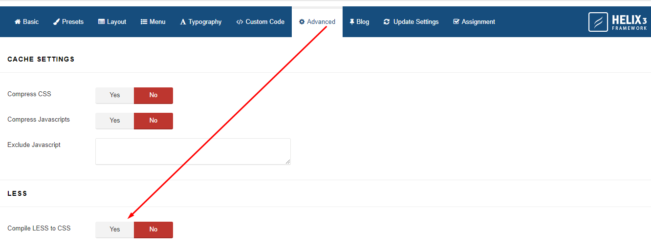

Support Agent 5 years ago #490
Hello Thomas Fisinger
You need to go your templates Advanced Settings -> Compile LESS to CSS and turn it Off. Screenshot_476.png
Thanks Michael for your response here.
