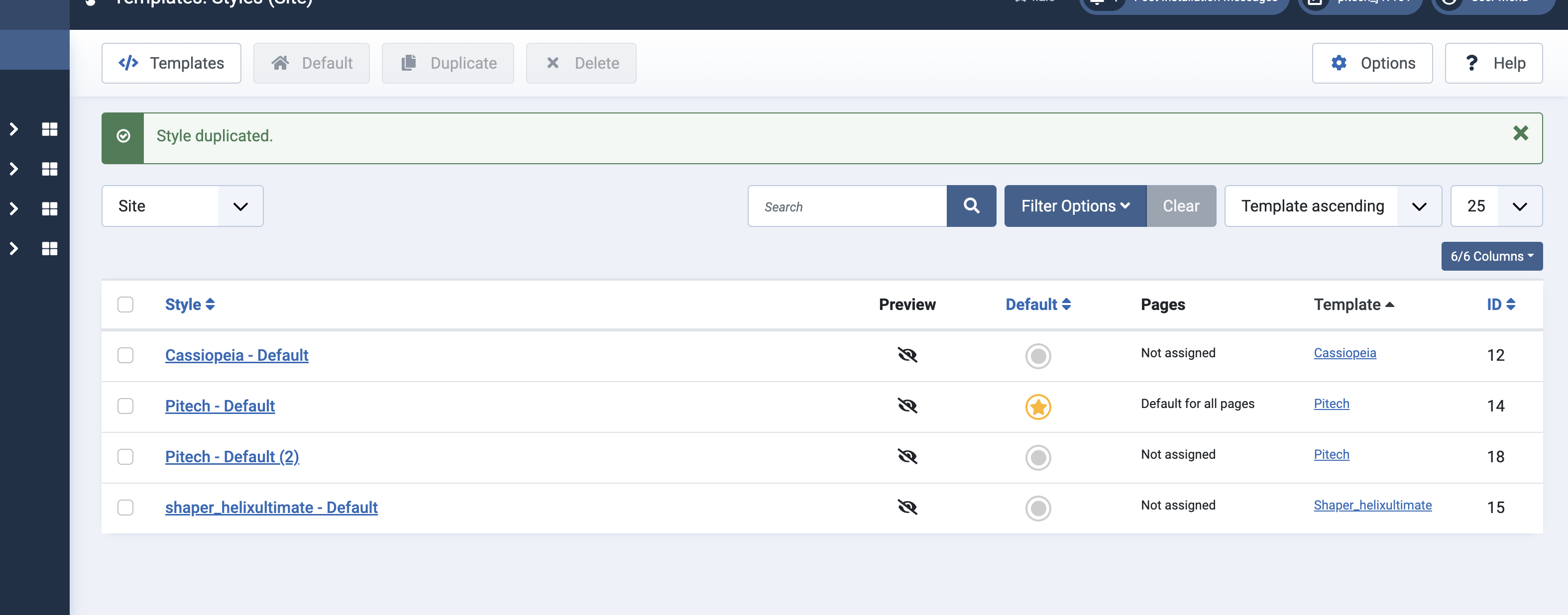

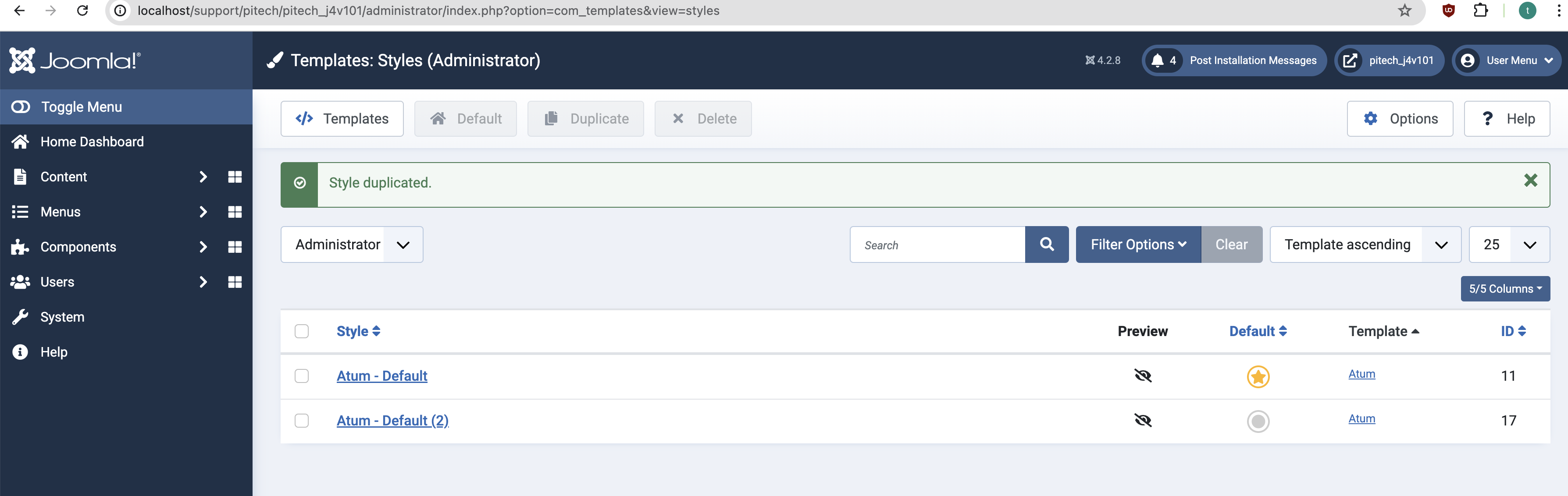

But if I select Cassiopeia - Default and make a copy, everything is fine, I knock out Pitech - it writes an error?
Not sure what you are trying to say. But, When i checked my end and it works fine without having any problem.

Hi!
I had the same error.
It occurs when I enter the template settings and use the save as copy option.
This time I did not enter and did as shown in the picture you have cropped in, selected helix ultimate template and copy.
It works like this.
