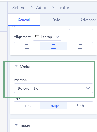

Hi Moni.
In Feature addon set that: Position > Before Title
becuase if you have "right/left" there is no space to display whole image and text.
OR
You have to use smaller image.
2nd issue that you may have is FLEX TEMPLATE (!)
Nighmare, if we talk about addons override. Many of thems were overriden by them. So we cannot support them anymore. Easy to proof it.
Make a simple test. Set "Cassiopeia" as you main/default template for 3 minutes and check that same page again. It will tell you where to search source of issue.
