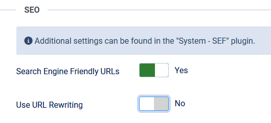

Paul I thought that only worked partially.
only the homepage works. all other pages I get Additionally, a 404 Not Found error was encountered while trying to use an ErrorDocument to handle the request
Even when I create a new page, it does not appear in the menu.
In many cases, webmasters (advanced & beginners) forget to update content of .htaccess file from Joomla 4 to new Joomla 5.
Sorry, but I didn't ask you to restore old .htaccess file, but to use the most current one from Joomla 5.1.4 package (and rename htaccess.txt file).
