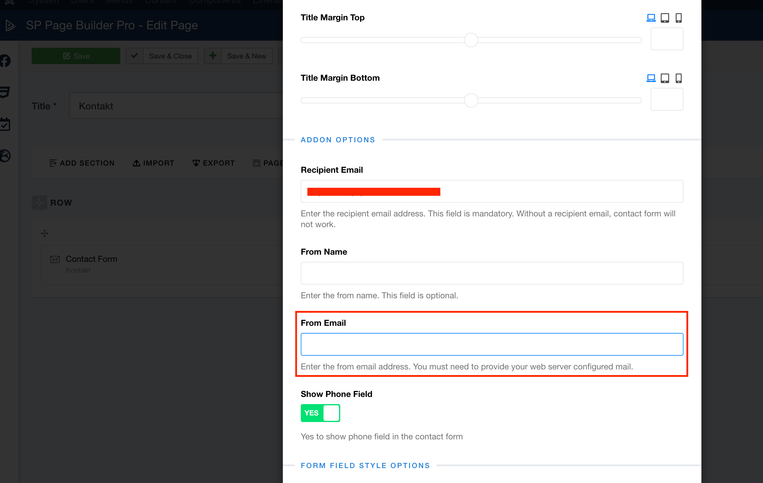

now I have a little problem with the Contact form addon. I was filling out the field with my email adress and then I was testing it. I become the message "Message sent successfully", but the message not arrive. I was sending from the joomla configuration a testmessage, that works without problems. The message arrive. From the pagebuilder Contact form not. I was trying it a few times.

the most importend is the recipient email, that I have. In the frontend I fill out all and send it. Then comes the message "The email was sent successfully". But the email not arrive on me.

Please fill up From Email option with your web configured email.
