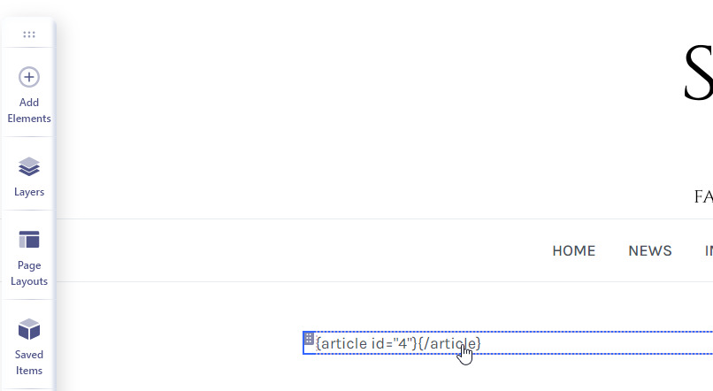

But with T4 framework/JA template problems I cannot help you. But I discovered that error is from login view (!) code.
When I enabled Shared Session in Global Conifuration, SSPB front-end editor now works, becuase I skipped the login screen. It means that probably problem is from JA Purity_iv template itself!?
The evidence that works
