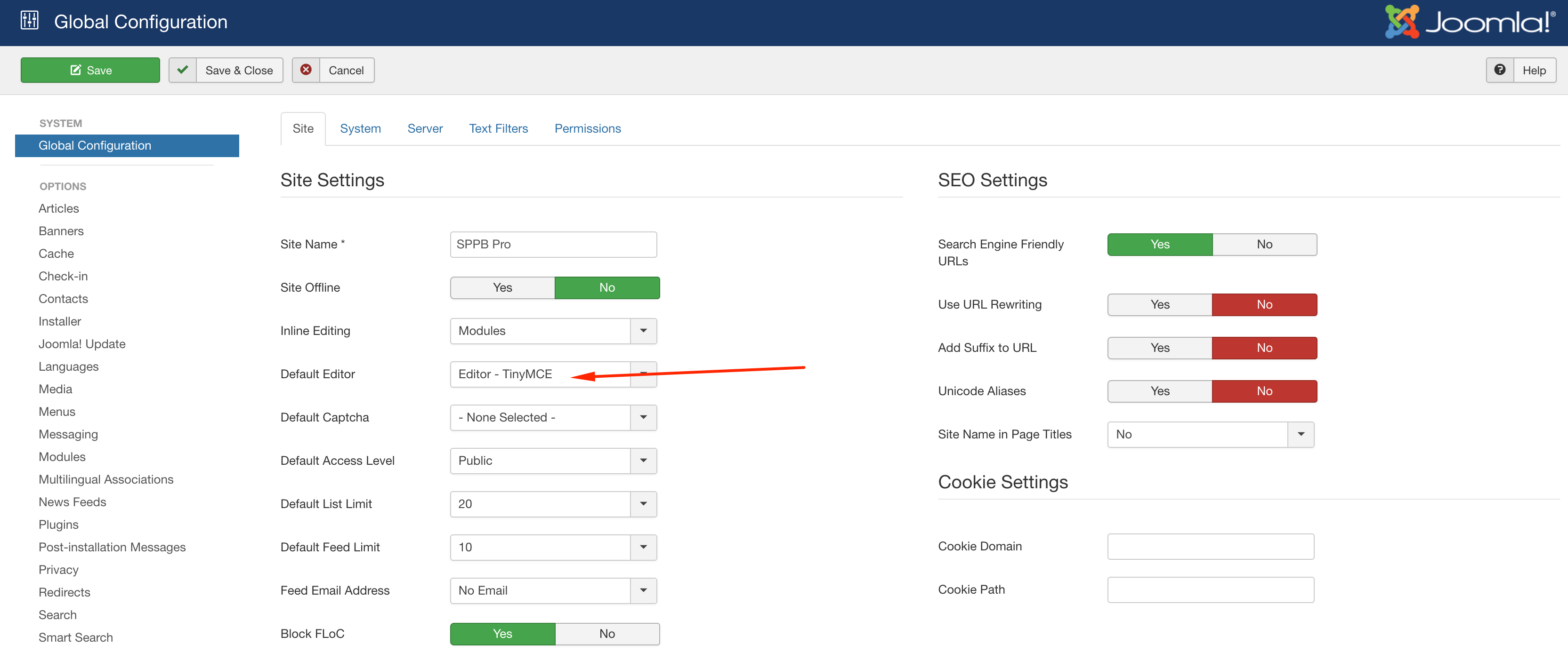

Is there or where is it possible to change the editor used within the Page Builder?
My specific request is, for example, to link to another of my pages (at one page, for example in a text field). What's the best way to do this?
Outside of the Page Builder (within normal Joomla pages), I can click on "add link to page" in the Editor and then have a selection overview of all available pages, so that the correct link is automatically inserted. In the standard editor in the Page Builder, there is only an empty field to insert the URL when you click on add link.
thank you!

Hello Andreas Urban
You can change your default editor in System -> Global Configuration settings on your administrator. You can try JCE if you want to use any third-party editor. You need to install the editor first, then set it as default editor. Then you will able to use it on any text editor in SP Page Builder addons or outside.

Thanks, some things are that easy ... (was just wondering using TinyMCE is full at Joomla pages and only very basic at Page Builder but using JCE is with full options in Page Builder as well)
