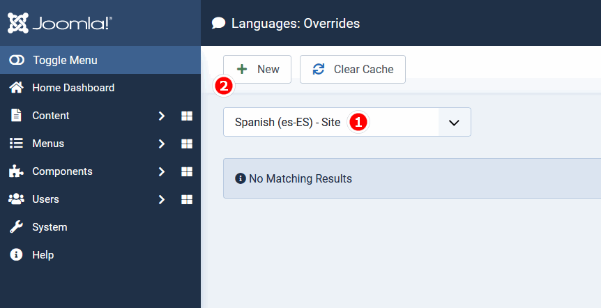

Have you tried to override phrase "MOD_FINDER_SEARCH_VALUE" for default languages, I mean DE, EN
Use Language Overrides

Thank you, that's how it works, too.
