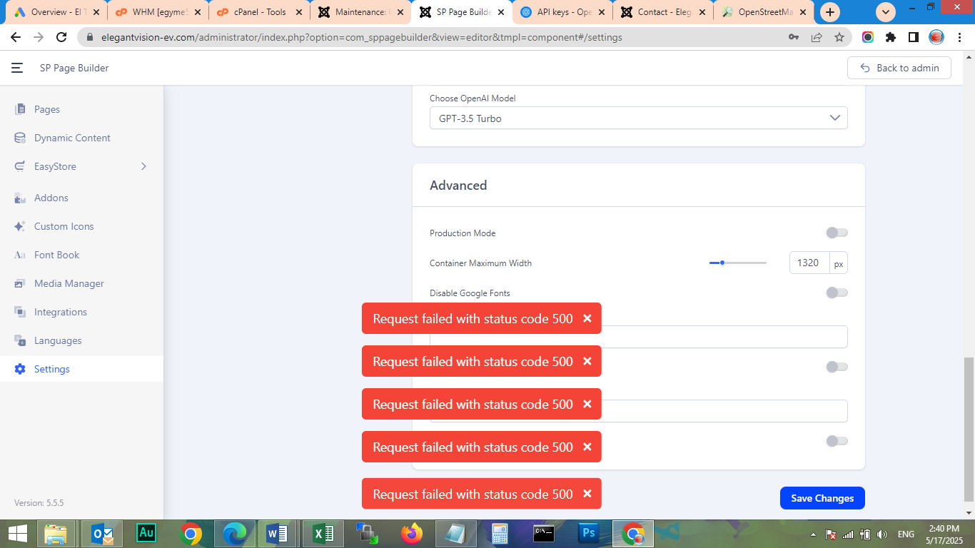

I'm having a problem in saving page builder pages especially option page
error message
"Request failed with status code 500"
Can you please help my with this
Thank you

Hello Girgis,
Apologies for the inconvenience and the delayed response — our support was limited over the weekend.
Regarding the issue you encountered with saving SP Page Builder pages and the “Request failed with status code 500” error: could you please check again now and let us know if the issue has been resolved?
If the problem persists, we’ll be happy to investigate further.
Thank you for your patience and understanding.

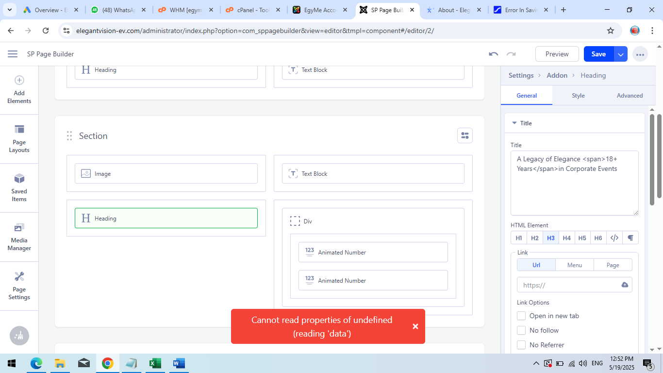

There is another error keeps popup when saving pages in page builder
Can you please help!

Atick Eashrak Shuvo Staff
Please check now

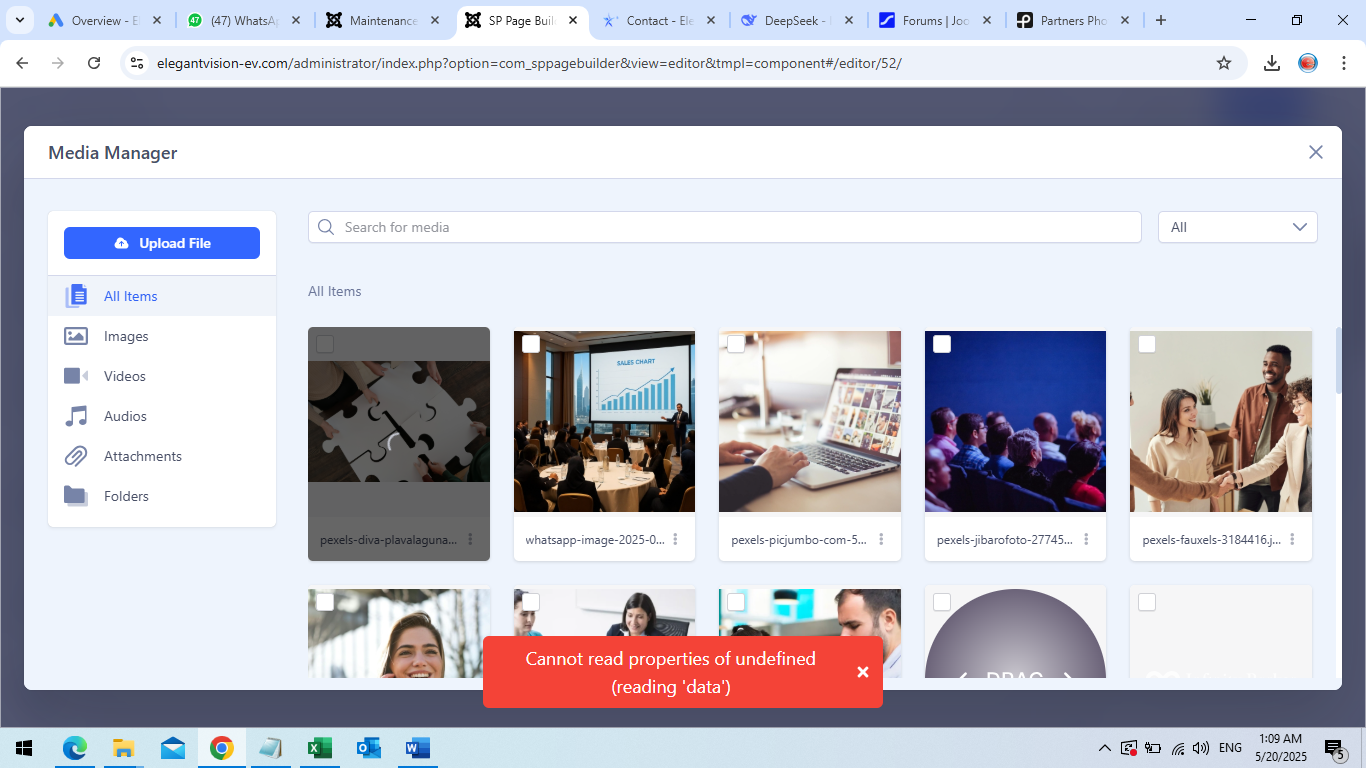

Can not upload images at media manager
I don't know where is the problem, your kind support is requested
Thank you
Girgis
Apologies for the inconvenience caused.
The issue appears to be related to a missing PHP extension—GD, which is required for image processing functions such as uploading images through the Media Manager.
Kindly contact your hosting provider and request them to enable the GD extension for PHP on your server. Once it’s activated, the Media Manager should function as expected.
