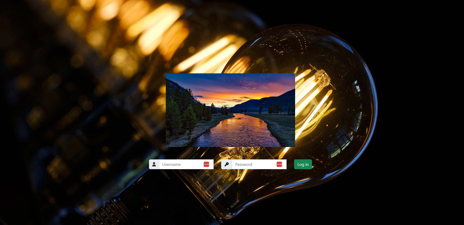

1 year ago #173929
Here we go again with the endless frustration over offline images and this template.
Perhaps I did not understand correctly, but there was never any difficulties with this.
Step 1 - Global Configuration > Site Offline > YES
Step 2 - Coming soon ON > Add background image > Save > Coming soon OFF > Save
Or just publish the module containing an image in Coming soon position.
All this is very flexible and allows you to make any appearance of offline page.
Here is both options on the screenshot

1 year ago #174077
Hi @johnny.
tep 1: Global Configuration > Site Offline > YES Step 2: Coming Soon ON > Add background image > Save > Coming Soon OFF > Save
I agree with you that this is not intuitive. Nevertheless, it is not so difficult. And compared to the standard Joomla functionality, is much more flexible for creating any appearance that a designer draws.
I work a lot with designers who draw as they want and sometimes rather complicated things, for the implementation of which through the standard functionality of Joomla, it would be necessary to really edit PHP.
In the case of Helix, PHP editing is not required. I don’t know who gave you such a stupid advice.

Hi Dave,
Yes you are right. The image is treated as background image. Will you let me know, how you want it to appear, please?
Thanks!
Senior Staff 10 months ago #210194
Ciao Dave,
Try that Custom CSS
html.coming-soon body {
  background-size: auto;
  background-position: top !important;
and please - if you have more questions - create a new topic, that one belongs to @Johnny.
